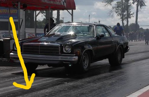

Having less wheel stand is better, again, to a point What race fan doesn't like to see a bumper-dragging, spark flying wheelie half way down the track? It's one of the coolest things a race car can do.
However, when it comes to safety as well as E.T., that front end needs to stay down. A good amount of crashes or mishaps on the tower side of the track happen due to drivers not controlling the car during a wheelie. It's hard to steer with rudders on a race car! Wheelie bars will help unload the car and prevent wheel stands, but they do just that, unload the energy that was lifting the car and let the rear tires spin. If all you can see is sky when you launch, and fast E.T.s are your goal, tuning should be done to lower the amount of power the car is producing during launch.

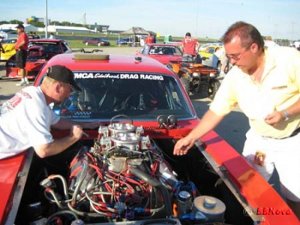

When starting out in drag racing, it's usually just you and a buddy or significant other. Or maybe you are alone. But there comes a time when you make the move to race more and more. When this happens, it's time to start looking for a crew. It difficult to find good people who are willing to sacrifice their own time for your own gains. But having the right crew behind you can make all the difference in the world. A crews job includes commonly known things such as working on the car, preparing food, etc, etc. But one important job of the crew often overlooked is to back the driver. Making sure the driver is in the right frame of mind, isn't worried if things have been done, and has focus on driving is key.

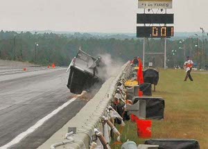

You are roaring down the track at 100+ MPH when all of a sudden, without notice, your car starts dancing out of control, what to do?! Of course you should try to regain control of the vehicle, stay out of the gas pedal, and let instinct take over. But 1 tip in addition to this is to pull the chute. Pulling the chute will not only slow the car down, but keep the back end of the car pointed towards the tower. With the back end pointed towards the tower, the chance of your front wheels giving you control of the vehicle is much greater. Remember steering a car only works when the front wheels are on the ground, with solid contact and rotating. It's nearly impossible to control a car that's sliding sideways; you are pretty much just along for the ride.
